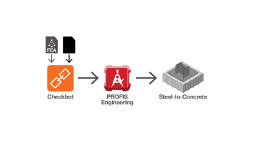

How are you today bringing the information from your structural software to PROFIS Engineering?
If the answer is “manually”, we have a better solution for you!
Checkbot is your solution
We have partnered with IDEA StatiCa to develop a simple and reliable integrationCheckbot. It acts as a bridge between your structural software and PROFIS Engineering, allowing you to transfer your connection data in just a few clicks. As a PROFIS Premium user, you get full access to all IDEA StatiCa Checkbot capabilities – included in your license.
