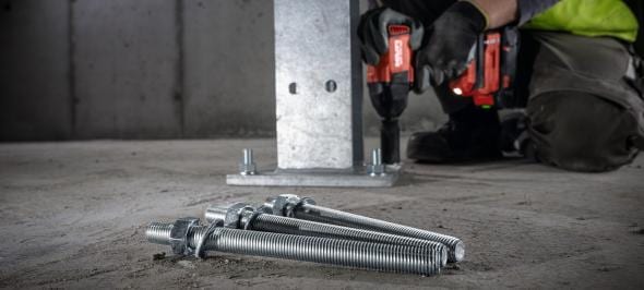

1    INTRODUCTION
Threaded rod assemblies are integral part of post-installed bonded anchors, making their quality paramount in ensuring fastener safety. Bonded anchors are extensively utilized to establish structural connections between existing and new building components, such as "steel-to-concrete" or "concrete-to-concrete" connections. The failure of these connections can pose a significant risk to human lives and lead to substantial economic losses. Hence, it is imperative to ensure that threaded rods are fit for purpose when used in anchoring applications.
