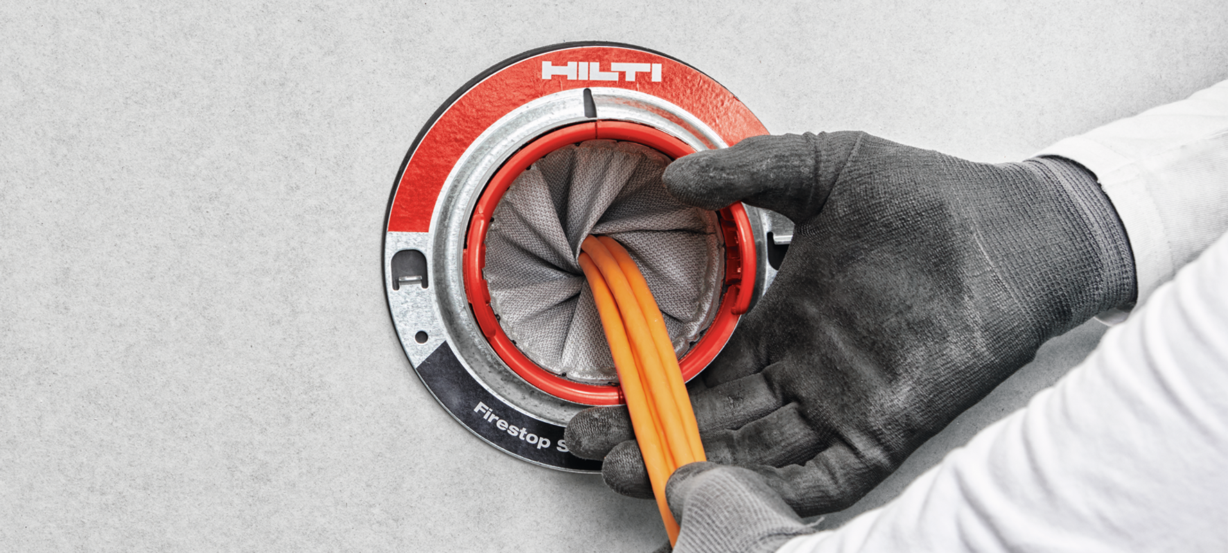

For electrical penetrations, the CFS-SL - Firestop Sleeve is the optimal solution in the Hilti portfolio. In the next section of this article, we’ll show you why it is a smart choice for use in hospital environments.
CFS-SL GA gangplate angle

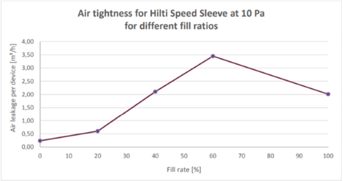

A sequence of EN 1026 testing at an accredited third-party institute “ift Rosenheim GmbH”, measured the air tightness of the Hilti Firestop Sleeve. A series of pressure steps were examined to cover a broad range of applications. The tests also covered a variety of cable fill ratios, from empty (0%) to 100% visual fill, to represent the increasing number of cables as facilities are scaled up. The following graph shows one of the several test series’ results and describes the air tightness behavior of the Hilti Firestop Sleeve at different fill rates (at 10 Pa):
Air Tightness Speed Sleeve at 10 Pa Graph
Testing compared 4” Firestop Sleeve air tightness performance at different fill rates, device installed according to manufacturer’s Instruction for Use.
  • Cables used: CAT6 cables (OD=6mm), end of cables sealed;
  • Fill rate 0% = 0 cables (blank);
  • Fill rate 20% = 28 cables; Fill rate 40% = 57 cables; Fill rate 60% = 86 cables;
  • Fill rate 100% = 142 cables;
    Leakage measured @ 21 °C; 52 - 57% RH, @10 Pa and tested according to EN 1026 – test reports available upon request;
  • Airflow in [m³/h] measured for over- and under pressure, chart displays average values
Air leakage for Hilti Firestop Sleeve fill acc. to EN 1026 – third-party test reports from December 2016

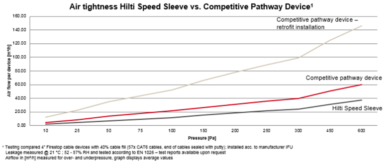

Testing of the Firestop Sleeve at different pressure differentials shows a high-performance Hilti Speed Sleeve Competitive pathway device compared to competing products.
Air tightness Hilti Speed Sleeve vs. Competitive Pathway Device
Air Tightness Hilti Speed Sleeve vs Competition Pathway Graph
Testing 4” Firestop cable device with 40% cable fill;
  • Installed acc. to manufacturer Instruction for Use 40% cable fill = 57x CAT6 cables (OD=6mm), end of cables sealed;
  • Leakage measured @ 21 °C; 52 - 57% RH and tested according to EN 1026 – test reports available upon request;
  • Airflow in [m³/h] measured for over- and under-pressure, chart displays average values;
Air leakage for firestop Sleeve at 40% fill acc. EN 1026 – third-party test reports from December 2016

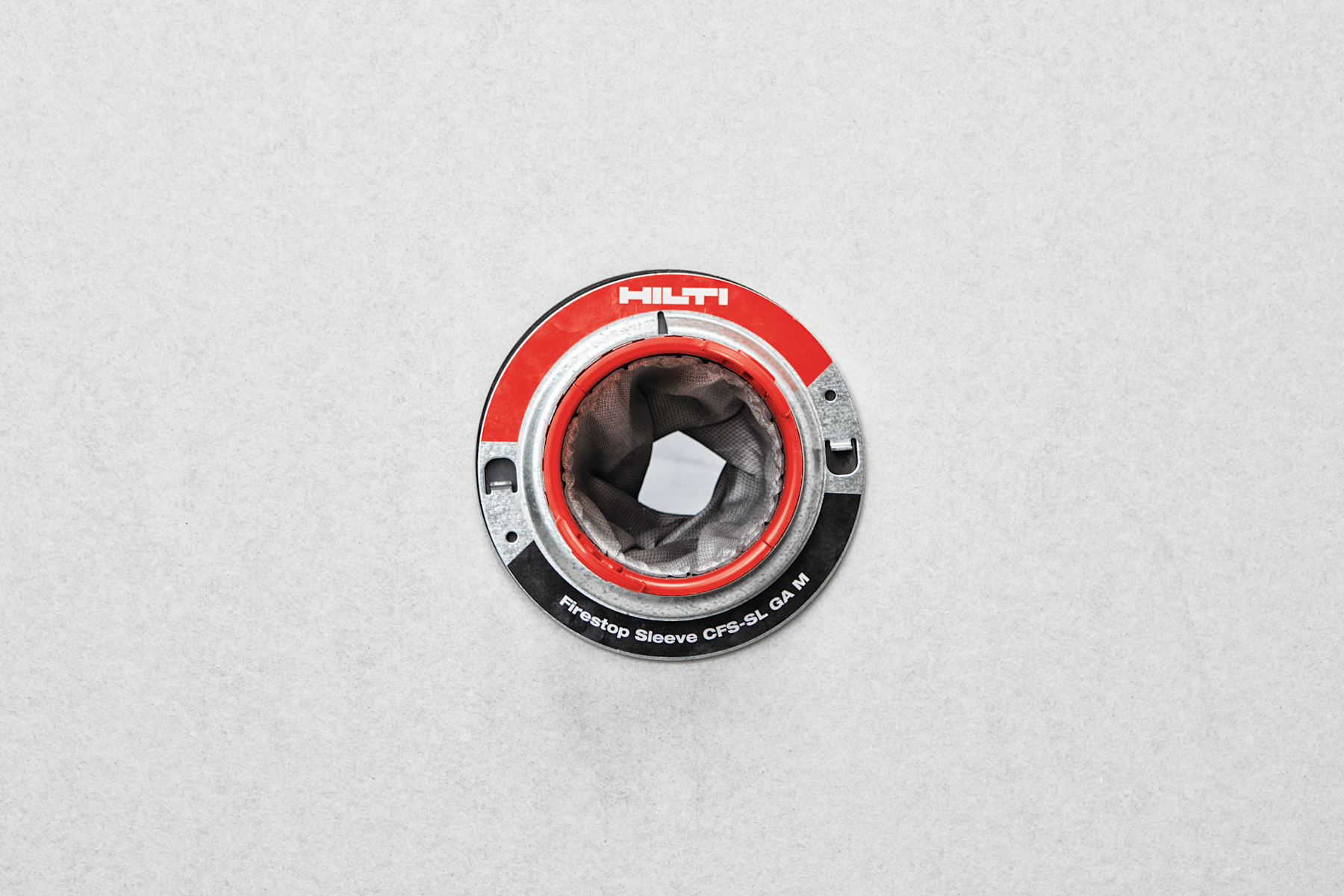

Firestop Sleeve technology results in superior airflow control
CFS-SL GA Open
CFS-SL Closed

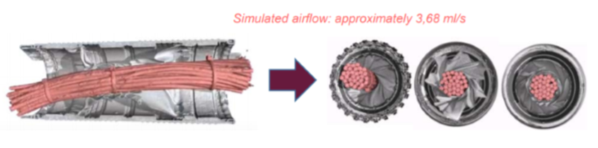

Neutron ray imaging at Paul Scherrer Institute in Switzerland allows us to look inside leading firestop cable pathways and show that the Firestop Sleeve has optimal airflow control, with a performance of less than 4ml/s of air transmission.
CFS-SL Simulated Airflow
Hilti Speed Sleeve CP 653 BA with closing mechanism to increase air tightness – third-party CFD simulation by Paul Scherrer Institute from June 2016
